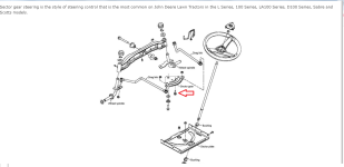

It doesn't appear on the diagram, but shouldn't there be something helping to support the plate sector in this hole?
Another doubt is how much the front wheels turn... it seems excessive to me, even hitting the drag links (LH/RH) at the end of the course.
There are ears on the Spindle Asm.(RH/LH), which would limit the spin...but despite looking like wear and tear, on the Axle Asm. (Front), there is nothing compatible with the same wear.
What do you think?

Nothing goes in that hole. You need to adjust both tie rods, as I’ll bet your wheel have major toe out. Also check to make sure the sector plate bushing and steering shaft bushings are is in good condition. If they are worn or the teeth are worn the gears will jump.

Yes, according to the diagram nothing there...but a screw with a limiting sleeve would guarantee more precision and less wobble in the secto plate.
Good, sector plate bushing minimal wear...steering shaf bushing, perfect...teeth little wear...
Talk more about "I'll bet your wheel have major toe out", I don't understand.

I found this material from John Deere... it's not the same sector plate, but it serves the purpose I think.
And it can even act as an end-of-course limiter for the steering.

I ended up taking advantage of that hole in the plate sector.
I made a bushing, crossed by a screw plus a wide washer and another pressure washer.
Now the plate sector doesn't wobble and there's only looseness between the gears... it's excellent.
However, when I align the sector plate, the wheels are slightly to the left, as is the steering wheel.
I'll have to change the geometry of the Spindle Asm. RH/LH).

If my draglinks were adjustable it would be easy, but... I'll try hard.
