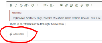

There is an 'attach files' button right below here...hit 'reply', and you'll see it.
