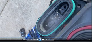

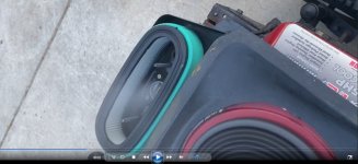

Now for the pics and the last detail. This is a 4 screw fuel pump design.
here are a few pics of the new carb and the 2 screenshots from the 19MB, 10 second video i made.
So heres the question. What is causing both of the carbs (original and new) to dump fuel into the intake like a drinking fountain getting everything absolutely soaked?
What more pics or tests should I do for y'alls wisdom to help solve this?
