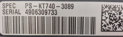

Which Kohler engine? Model and spec numbers please.
