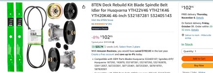

Am I correct to assume this is a manual handle operated deck?
Can you give a full top view of the deck and pullies when you get an opportunity.
The reason the idlers are wide and at a bit of an angle is normal. It compensates for the deck to be set a different cutting heights.
Your belt dilemma and modification have me wondering if you are ordering the correct belt from an actual parts vendor or Amazon.

yes, manual blade engage. ...I've learned that the big main pulley should be at an angle, but you are suggesting that littler idler that the belt tensioner connects to, should also be left at the angle it is at?.... I was just about to 'level' it, but will wait............the last belt (the one that just broke), was taken from this kit. I haven't installed the pulleys etc yet, but i did use this belt.
