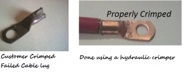

That is what you are looking for. A good crimp turns the copper strands into a copper block if you will. Best is a hydraulic crimp tool.Also here one that was over crimped that actually fused all the copper wire strands into one solid part.
If it gets hot enough to melt the solder then the insulation has already melted & started to burn and the battery has probably exploded.That is what you are looking for. A good crimp turns the copper strands into a copper block if you will. Best is a hydraulic crimp tool.
Far as soldering goes, if you had a corroded connector drawing excessive amperage, that will heat up. Could get hot enough to melt some solder. Course that would be an extreme condition with a much larger starter than mowers use. Probably be fine to solder a mower battery lug. Still prefer to crimp battery connectors.

The harbor freight special... I use that too. Works well. Only thing, they have dies for down to 16 or so gauge wire, but not really large dies. Wish they had dies for 0000 wire. I was always thinking of grinding the odd ball small ones to the size I want, but never got to it. The ones you show on the far left look larger than what came with mine.I use this:View attachment 57614
