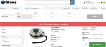

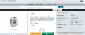

You multiple choices in US but don't know about the UK.
According to the US site it is still available.

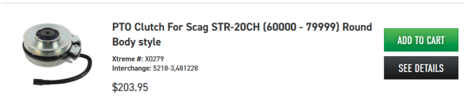

Xtreme has it under
Stens has it under (Note this include my dealer cost.)
And even Ox Clutch has it
On Amazon you need to search using the SCAG 481228 part number. Just note some are listing Warner 5218-62 or 5218-36 as a possible but they are a reversed layout.

Buy the Xtreme clutch it is head and shoulders above the rest. Have been using them for years and have yet to replace one. Usually about half price OEMs.
Xtreme has it under
Thank you for all that information, very helpful and much appreciated. I just wonder if the other info. on the old clutch (i.e. CMSS-175) is relevant at all ?
That advice is very much appreciated. Thank you. I need to find it in the U.K. if I can but you have been very helpful and thank you.
