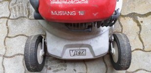

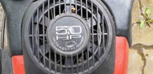

Victa Mustang 18 Ultima 4 stroke 5 hp (1994) lawn mower with Tecumseh engine.
I thought the starting problem was fixed by changing the ignition module, but today, after 2 weeks' absence, the same starting problem has reappeared. After priming many times, the engine starts at the first pull, but after having used up the primed gasoline, it stops again after a few seconds. So there still is a gasoline problem somewhere. I took off the carburator and noticed that the gasket between engine and carburetor (the big one) is damaged. Also, the gasket between the carburetor and the air inlet is not perfect any more. The gasket of the floater chamber seems to be ok.

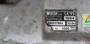

On the carburetor reads 1579H4M.
