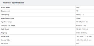

Apologies once again:
28M707-1162-E1 Code: 980325ZA
Hmmm still not giving all the engine info but I took a look at 1 of 200+ 28M707 and here is it valve clearances for the L-head.
The valve clearances you are quoting are for an OHV engine not a L-head.
Now if can pick which of the following is your engine would help looking it up.
I got the following specs

I reviewed my findings and it seems that the valve specs are as I stated earlier:
Intake: .003 - .005 in
Exhaust: .005 - .007 in
My current clearances are:
Intake: .006 - .007
Exhaust: no clearance
115
12,462
  • / Updated 4:40 pm - Clarifying Question - Re: Briggs & Straton 28M707 1162-E1; L Head - valve seats and clearances
Intake: .006 - .007
Will you get off those specs as I am personally pulling the info from the dealer's Briggs' Power Portal.
Okay the specs for this 28M707-1162-E1 engine are the same as I previous quoted from Briggs Power Portal.
This is the last time I will repeat myself.
Valve Seat PNs.
And here is the instructions on valve seats from the service manual.
Personally I would leave the exhaust seat alone and just adjust the valve clearance if the seat is not pitted.
Valve Seat PNs.
Guess I'm full of apologies today ... got the damn specs off a "spec" sheet ... clearly wrong.
Thanks for your patience. Interesting that you'd leave it alone.
So even though the exhaust valve will travel further than the intake valve because the seat on the exhaust is pushed ... that's ok? Seems like the valves should be parallel to one another (only difference being clearances) to have the proper stroke forces. Am I wrong again? Wouldn't shock me.
