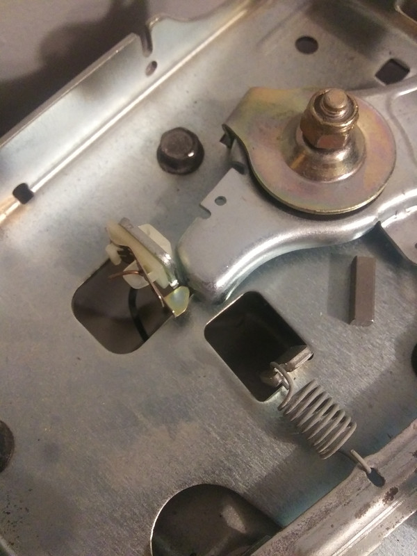

also, now to find out why the kill wire is grounding.
Yeah, I noticed there is just an idle adjustment. I will have to take the coil off and see why it is grounding out. The positive is that it is actually running better than last year and the year before. We're probably on the right track.
Follow the kill wire... It hooks to a plastic insulator under the gas tank on the control panel... It could have come off. And when you move the throttle all the way back the throttle lever makes contact with a metal tab on that insulator to kill the spark.
There could also be a spot in between where the insulation has failed on the wire.
