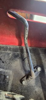

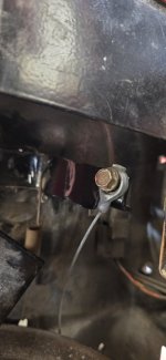

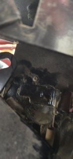

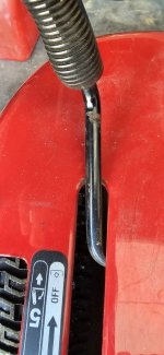

Below is the PTO lever: 1 - pulled all the way back on the top of the right fender. 2 - Under the fender outside of the battery box, 3 - the lever attached to the PTO cable inside the wall of the battery box, and 4 - the inside PTO bracket.
By the pictures, there is no PTO switch. The PTO cable goes down to the deck where it attaches to a spring.
So I am at a loss since there is no PTO switch, where is the electrical connection to the PTO lever/cable that tells the ignition the PTO is engaged?

What is that electric connector behind the cable in your third picture. Most likely that is the pto safety switch connector.
80
10,285
Yes that is the PTO switch hidden back there.
