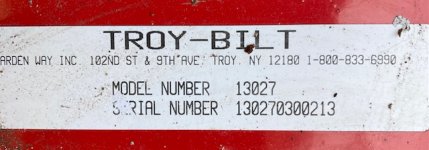

Post your model number from under the seat, and we can give it a try. Better yet take a picture of the ID tag which ensures we have the correct number.

OK here is a shot of the label under the seat.
Thanks in advance for all the help, been fighting this for 3 days.

Not going help much but it is a 14 hp Suburban. Very old...
