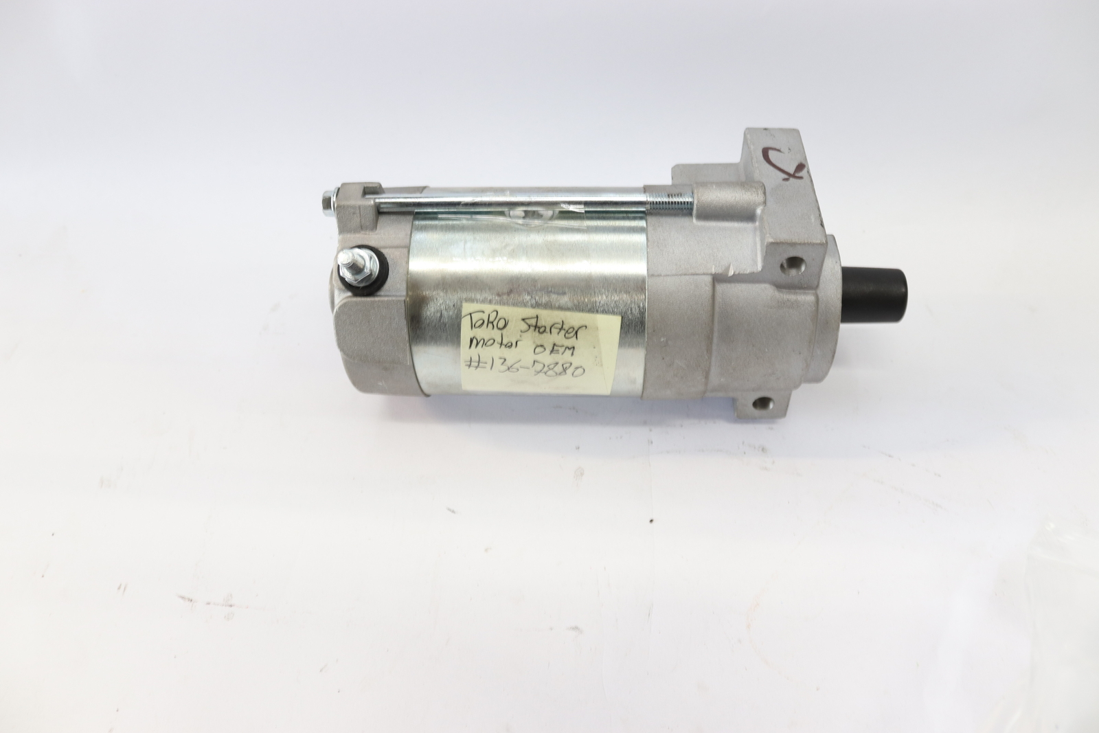

This particular Toro Titan has the Toro V-twin rather than the Kawasaki or Kohler motors. Does anyone know what the correct starter is? Ereplacement parts gives a part number of 136-7880 while the Toro website gives a part number of 133-9828. As far as I see visually online they are identical starters, just different prices.

Toro updates their part numbers regularly. The 136-7880 will work.
So will a starter for a Loncin 708cc engine aka Predator 708cc engine.

Thank you. I have a new, open box Toro #136-7880 starter on order for $175. I really hope this is the end of the line for starter/solenoid failures!
When I get around to it I'll dissect the original starter. Can't imagine why at only 59 hours it would be crapping out other than it's purely a lemon?!?
