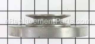

That's the pulley that goes blade to blade. I am talking about the V-belt pulley on top of that mentioned in your post.
116
12,591
120-3334 superseded to 130-6664
side view
top view
Bottom view

Well I ordered 120-3334 and that's what I got. I am now concerned with what washer or washers to put under the nut to hold the pulley tight. As I said the various serial numbers groups have gone between a spring washer or cup washer or both.
