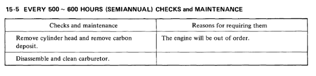

“ Think most engine manuals say like every 5 years, pull head and clean valves.” This is something I’ve never seen or heard. Personally I wouldn’t do this on my own equipment or charge a customer for unless there is some other reason to pull the head.
Not for nothing. I looked at 3 of my push mower engine manuals. One a Briggs, one a Kawasaki and the other the gutless Honda GXV160. They all say at X amount of time, clean the combustion chamber....
Briggs manual
Kawasaki manual
Honda GXV-160 engine manual
#22
S
slomo
Here's a Kohler engine manual I just grabbed off the internet. Every 100 hours have the combustion chamber decarbonized.
#23
S
slomo
This is from my king shiz nit Wisconsin Robin EY20V or WI-185 engine manual.
#24
R
Ok, I’ll concede that it’s being posted in owners manuals. That’s what they say in the manuals to CYA. I guess you’ll tell me that a majority of home owners would even think about doing this Or know what it means. I’ll still stick to my statement, “NO NEED TO DO THIS UNLESS YOU SUSPECT OTHER PROBLEMS “.
