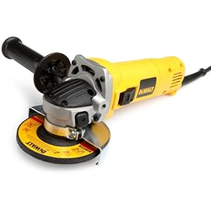

I'll have to go and pick up a hand grinder. I never thought of using one to sharpen the blades but it makes sense. A hand grinder would also be a lot easier to control to get the blade the way you want it.
I tried filing and using a bench grinder but now I use a 90 degree hand grinder. Its the easiest cleanest and fastest way to sharpen thoses blades.(off the mower of course)

What kind of grinder do you use?
I have been using one that looks like overlapping sandpaperinstead of a solid grinding wheel. This seems to work for me but I was wondering what you use.
