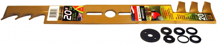

they seem to bypass the proprietary shape hole thing with slots - dunno about other fitment issues - just wondering......

Here is my take on trying something "generic" ...
1. The GW Blade mount is PLASTIC, personally I want maximum engagement with the blade, which you will not get with universal oversized openings.
2. The motor shaft on these mowers is not very large nor is the blade retaining bolt, so I would not want to mount a blade that is any heavier than an O.E. blade. Also, the bearings in the motor that the shaft spins in are sized to match the small shaft too.
3. The O.E. GW blades are also thinner steel and not as wide as a typical lawnmower blade, so I doubt there is a generic one out there as THIN or as NARROW as the GW blades. Thicker and/or wider is only going to ADD weight which will drastically reduce run time and shorten motor life.
4. The GW locating chevrons also "center" the blade, where these generic blades use washer spacers to reduce down to the mounting bolt size ... it would be pretty tough to get a generic blade perfectly centered without the chevrons to avoid any unbalance.
Bottom line is any added weight is only going to overwork the batteries / motor and any unbalance will probably wreck the light duty electric motor pretty quickly.
Doug
