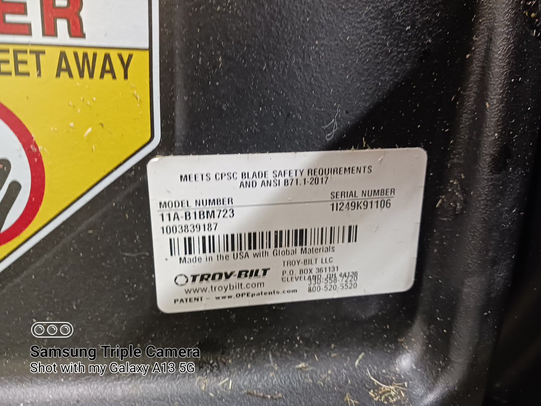

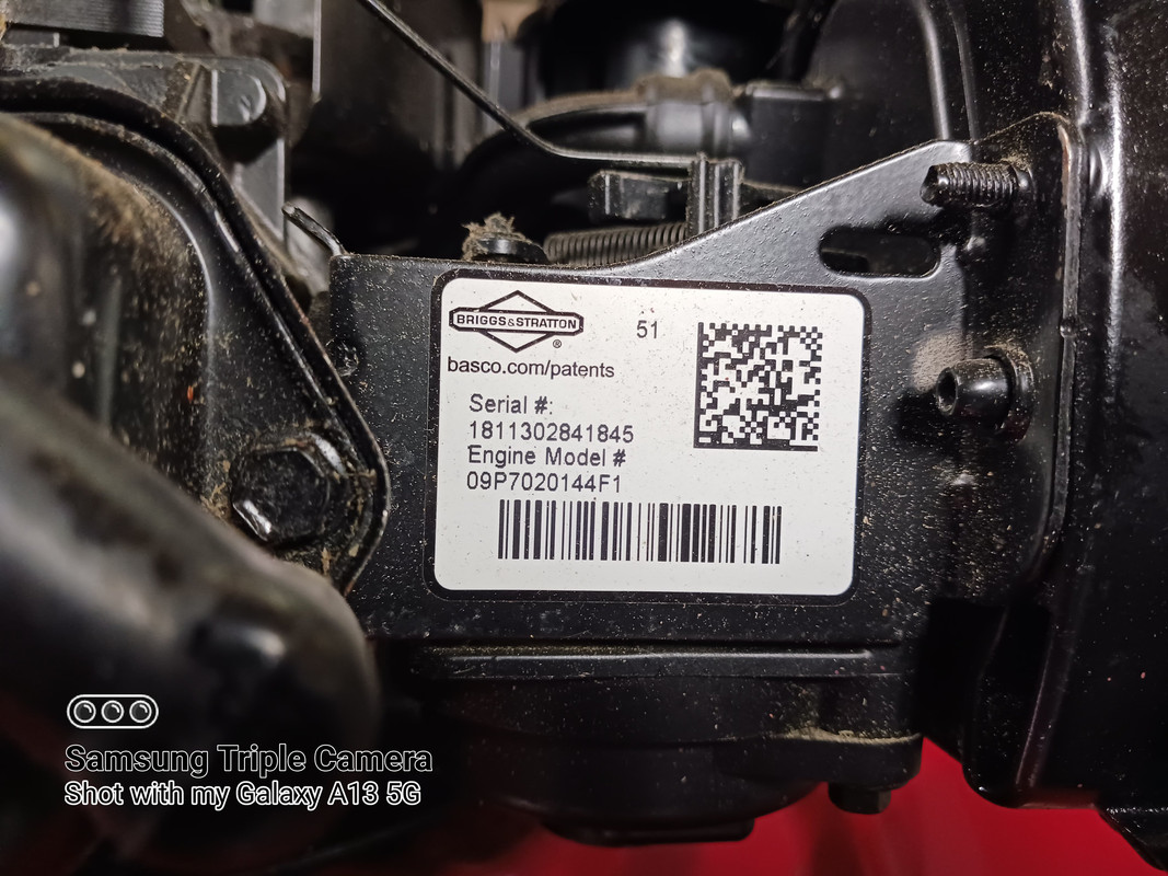

What do you mean “won’t pull over”? Is the bail handle moving the engine brake when you pull it back? Try this, remove the spark plug and see if it will turn over. If it does it was probably hydro locked. Second, when you post back please include all engine and unit numbers so we can see what you have.

Rivets,i tried posting the engine nos.picture but it said the attachments were too large.

Very simple unit, I’ll give you a couple of things to try. First, as I posted earlier, did you check to see if the engine brake is releasing when you pull back on the bail handle? If not you have a problem with the cable. Second, did you remove the spark plug and see if you can pull the engine over? Do this slowly, as if it is hydro locked gas will spray all over. Post back with your results and we will work from there.
