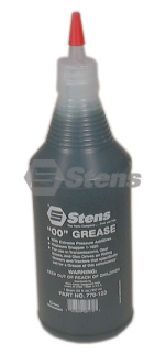

Some lube is better than nothing.
But.... I would of used Snapper's 00 grade grease if it was mine. That tacky red mess doesn't flow at all. Once the initial turning gets done, no grease will be picked up to further lube anything. Grease is a thickened oil. See where this is going? Key here is flow and recoating parts.
You can get this Super S 00 grease at Tractor Supply for 6 bucks. I've used a ton of it, good stuff.
