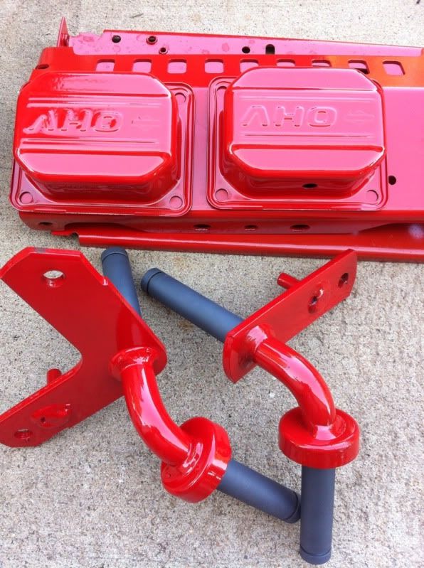

Here's a pic I posted on a couple other threads here showing an idea though.
I do plan on posting a build thread of finished product,though it won't be finished till this winter earliest probrably.

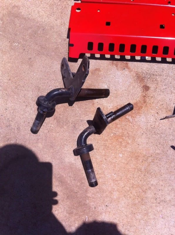

Here's a before pic of the spindles.
