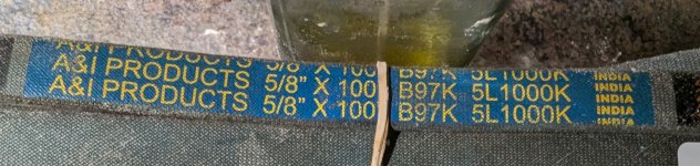

I bought a belt here locally this am, and it was marked 100" x 5/8". The "red belt" which is on the machine ( and destroyed ) right now is 100.25" x 1/2" and way too big.
So I tried to replace this new belt in place of the red belt and it looks great on a spindle it fits perfectly so the spindles pulley height must be 5/8" tall. But when going to the other side of the machine and trying to finish wrapping it, I could not. The new belt it is too short. Either unbelievable or predictable?
The only thing I can think of that might work is to remove the small idler pulley ( side with the chute ) and somehow wrap it around the pulley and hope that the bolt when moving the whole thing back, that bolt can get "on center" to the hole in the mower deck frame. I have not done this yet. Is this the way you would normally put on a mower deck belt? Meaning you have to keep the small idler pulley off, wrap the belt around the small idler pulley and then move it to where it needs to mount?
If this does work then my first thought is the blades will always be in a run state, because everything is so tight. The 5/8" fits perfectly to the spindles pulley although. I have no clue how to proceed next?
Jim
