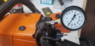

I have 5 chainsaws. 2 of which are running high compression and advanced timing. If you try to start them without using the compression release they break starter pawls. I run regular gas in all of them with zero issues. All the internet mechanics quote the Stihl manual but i am still waiting for someone to show me a saw damaged from preignition from regular gas I put it in the same category as "starting fluid will blow your engine up" crowd. Internet wives tale with no proof.20210206_162104.jpg

200psi comes out to 13.6:1 static compression. That is pretty high. Aluminum block/head helps cool the cylinder.
From the MS 250 manual below. Stihl recommends a minimum 89 or higher octane.

Stihl recommends because it needs it or is that just corporate covering their *** documentation??? I have worked on hundreds of saws over the years and pretty much all running regular gas and i have never seen a saw with preignition damage.
200psi is up there. I would say it needs it. 89 octane is a bare minimum at that.
Just follow the manual. Why risk it?
Would suck running another fuel can just for a saw but, some of those saws ain't cheap.
