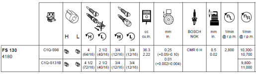

If you tune only for best speed then that might be the problem.
These are the initial mixture settings and speed settings/
Carburetor low speed tuning.
