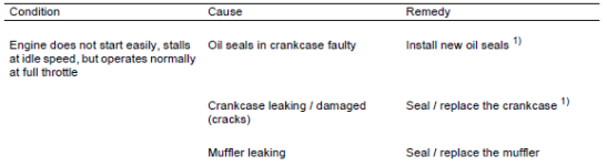

Two strokes require both crankcase compression as well as cylinder compression
Crank case compression is controlled by the seals at each end .
You test them in both pressure & vacuum
One of the signs of worm seals is engines that are very hard to start cold but start fine during use
Or start very hard on Friday afternoon, work perfectly all weekend but be impossible to start next Friday when the seals have dried out again.

Just finished doing a pressure and vacuum test on the unit and all is good with it, no leaks. Let it sit over night under pressure and did the same with vacuum all test held. I even put the whole thing in water to see if and bubbles showed, and did the soap spray and no bubbles.
