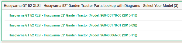

To make the look-ups even more problematic is that inexperience doesn't take into account the different variations that a particular model might have as with this one. There is at least 3 variations of this model so you must use the long model number from the serial number tag.
Now as the two bushings one is listed the frame section and the other is in the steering section.

WHOA! This was sold to me, by a dealer, as a 2015 unit in 2015. The model number behind the seat has the numbers 178-00. Under the hood the model numbers end at 178. Looks like it was at least two years old when I bought it. I'm not very pleased if this is true! Found the part and 227 should be the correct upper bushing for this mower. However, it's so sloppy it can't be correct. Is the 228 smaller? Maybe I should just bite bullet and buy one. Thank. Tom
#12
Actually you got a 960430178-01 since it is the only one that use the white (natural) plastic bushing. Sometimes the labels are off but normally the serial number tag has the right revision listed.
