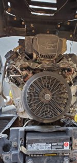

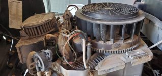

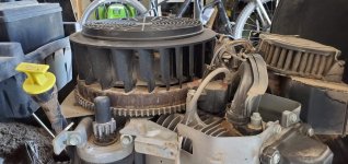

It's dirty under the shroud but I don't think it's so dirty it would cause it to over heat. The fins don't have any dirt caked in them. Mostly just a thin layer of dirt everywhere. I'm cleaning it off anyway. Cleaning under the steering and control rods behind the engine. Lots of dirt piled up in there. I almost wish there was more dirt on the fins so I could clean it off if it was an over heating problem. Do you think there is dirt behind the filter that is causing it to not get enough air? I can maybe get that apart. Anything else I should look at?

OMG, that little guy is FILTHY. Toss the Ken and Nancy air filter immediately. That little guy is packed up with grit and blocked solid. LOL wow
What is that to the lower left of the oil dipstick, last picture?
You need to pull the pan like air deflectors/directors off and look under where they sit. These pans surround each cylinder and those cooling fins. These are air cooled. Get drastic on your cleaning ritual. Clean it like a new engine at least monthly.
After every mow, I would blow off with a backpack blower or compressed air. You need to get serious about keeping her clean.
All those connectors are packed up with grit. Amazing.........
