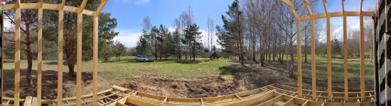

No twine here. We cleared the whole plot in winter (chainsaw, consolidate deadwood >1 inch diameter in a corner, abuse a mulching push mower to mulch everything <1 inch diameter) and were left with this:
March 29:
April 24 (both photos the same day...)
Then...left it until June 14 (working away) to come back to this and decided cleared enough to get to the building area (red smudge between trees) before decided that we would die trying to clear a "demilitarized zone" around it with the push mower (80-90F, 50-100% humidity and thunderstorms - so unworkable due to mosquitos and horseflies if you're too close to tall wet meadow weeds)
It's this stuff that's stringy. Stinging nettles, white flowering weeds, and wild raspberries that you can't see over the top of whilst standing or mowing. If we can once get them down to grass level - and keep them there - I think it'll be fine. Right now it's like trying to cut a wet fishing net. (with added stinging leaves and biting flies...)
