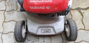

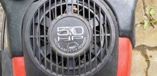

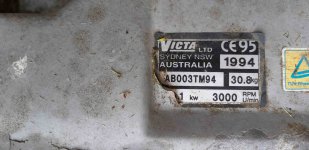

AB003TM94 reads on the label of my Victa Mustang 18 Ultima 4 stroke 5HP (4,1kW) lawnmower bought 1994. Two months ago it stopped starting. The expert states that there is no spark, ignition module should be renewed.
Which engine is in this mower? Tecumseh or Victa. I have still on paper a "Service 1994" booklet with "Tecumseh" on the front page. According to AI it should also be a Tecumseh engine. Definitely no Briggs&Stratton and no two stroke Victa. So I assume it is a Tecumseh engine.
Which Ignition module? Ignition Coil 34443 3HP-7HP for Tecumseh - is that suitable?
https://www.amazon.de/Zündspule-Tecumseh-Module-Tecumseh-LV195EA-OVRM105/dp/B0837CN35H - is it that one?
By the experience that these units are indestructible there must be plenty of them still around.
Can anybody help?

You are correct, the ignition module you will need is Tecumseh part number is 34443, superseded to Tecumseh part number 34443D.

Ignition module and spark plug replaced. Cost about 21€. Starting immediately on the first pull. It would have been a disappointment if I had to buy a new mower after only 30 years of use of this one.....;)
