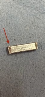

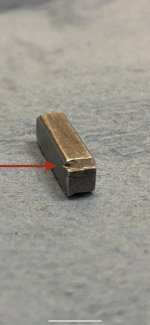

Just to conclude this thread...
I didn’t find any problems with the crankshaft taper or key way - the new flywheel fit perfectly and I made sure the taper was completely dry before installing and torquing it.
I did take a second look at the old flywheel and key and found the key actually did have a damaged corner, so I’m sure that also played a part in the flywheel cracking.
Thanks again for the help.
