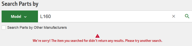

Also please verify model number.
JD Parts results>
