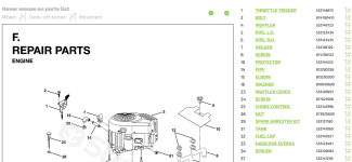

What site can I go to to get an explosion view of my husqvarna YTH 18 kohler command 18hp engine?? Can anyone suggest one?18 HP Koehler command on a husqvarna YTH 18. All of a sudden it just stopped dead in its tracks, no noise, no smoke, no nothing.? Couldn’t turn the engine over at all. It’s like it seized up, took the spark plugs out and still could not get that crank to move. had a guy come out and look at it and he said it might be the electric clutch?? He said take the nut off at the bottom of the pulley and see if you can turn the engine that way if you can then it’s probably the electric clutch..when it goes bad it locks up the engine. Any thoughts??

www.partstree.com
Please you got to be patient with us as some of us like myself run our own shops so we not just sitting by computer 24/7. IL like myself is probably snow bound at the moment. At least the roads here have cleared but I got watch out for the black ice in the morning as I go out for food and it will below 20F so I don't want get into a wreck.I just want to be able to find an explosion view of the entire engine W/ parts list & im just not finding ANYTHING adequate, not even close. Why is something so simple yet so hard to find, I’ll fix the damn thing myself if I can just find what I’m looking for![]()
I’m sorry u took that personal, wasn’t aimed at all you fine folks who deal in these matters, I was referring to trying to find some online site thru my browser, you never get what your looking for, it drives you crazy. Thank you for getting back to me & im sure I’ll find something to work with sooner or later.Please you got to be patient with us as some of us like myself run our own shops so we not just sitting by computer 24/7. IL like myself is probably snow bound at the moment. At least the roads here have cleared but I got watch out for the black ice in the morning as I go out for food and it will below 20F so I don't want get into a wreck.
You just got know where to look once you have the correct info. It like I have a Chevy but without the model and year. Even then in the glovebox is a detail options list of code numbers for 2000 model. Many of us have spent years looking up parts but even we need the basic info to work from.
And most online parts lookup you drop the "S" from CV18S-61533 so you look up CV18-61533.
Thank you ILENGINE, I’ll give the site a look seeOK the 2825916331 serial number comes back to a CV18S-61533
