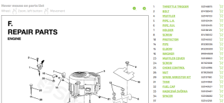

What site can I go to to get an explosion view of my husqvarna YTH 18 kohler command 18hp engine?? Can anyone suggest one?

I just want to be able to find an explosion view of the entire engine W/ parts list & im just not finding ANYTHING adequate, not even close. Why is something so simple yet so hard to find, I’ll fix the damn thing myself if I can just find what I’m looking for😤😤😤

Please you got to be patient with us as some of us like myself run our own shops so we not just sitting by computer 24/7. IL like myself is probably snow bound at the moment. At least the roads here have cleared but I got watch out for the black ice in the morning as I go out for food and it will below 20F so I don't want get into a wreck.
You just got know where to look once you have the correct info. It like I have a Chevy but without the model and year. Even then in the glovebox is a detail options list of code numbers for 2000 model. Many of us have spent years looking up parts but even we need the basic info to work from.
And most online parts lookup you drop the "S" from CV18S-61533 so you look up CV18-61533.
