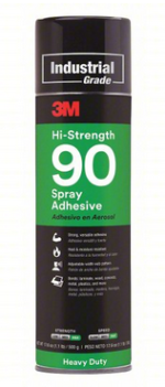

Make sure the glue you use, is foam safe and will not burn it away.

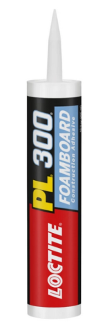

For whatever glue/adhesive you decide to use, read the label. Many of the foamboard adhesives have 1-week cure times.
Contact cements work great but breaks down with time and excess heat.
