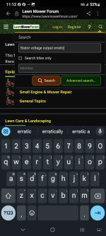

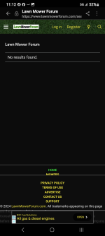

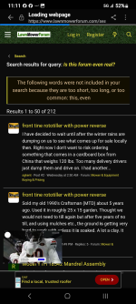

I don't want to waste anymore time than I've already wasted (an hour +) but over an hour ago I needed help with erratic volts coming from my mower stator. Erratic meaning just that. The voltage output fluctuating. The volts are up the volts go down, pretty much self explanatory right with no need for model and such. The pictures I attached are results. Does anyone know why this happens? Everything on the outside and up from flywheel is good. Good meaning brand-new and tested. The only thing I could think of or that I have found (worthlessly) would be the inner magnets. What would be the symptoms of the inner flywheel magnets bad or broken? The mower stsrts, has run great throughout the summer now will only charge at hit and miss meaning it shows charging over 13 volts for three seconds then for a second drops to 2 volts or 4 volts then again over 13 volts for 3 seconds and then for a second drops to between 2 to 4 volts. That is my definition of erratic and if i should have worded it better please let me know to help myself in the future to find things. This is not hateful and I really don't expect a response since its not searchable. Thanks if there is a response.
