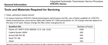

My parents bought a Cub Cadet RZT SX w/ the 46" fabricated deck several years ago. We all like to mow with it and find the steering wheel zero turn to be just right thing for mowing their sloped and angled yard. The only issue we had corrected under warranty was a loose stator wire that kept the battery from charging and shutting down mid stream when mowing. We do all of our own equipment maintenance between our place and theirs and have had no problems with a quick 2 qt oil / filter change and a few grease fittings. It's been a good mower and my mother even feels comfortable on it. I read through the manual and did not find too much information on hydraulic wheel motor maintenance which got my curiosity going. I knew when my parents bought it that it was a lower end unit - but comfortable for them and sufficient to do the job they needed. Besides they were tickled with it and no one had any right telling either of them that they bought a cheap mower lol. Changing engine oil and filter, cleaning / replacing air cleaners, greasing and cleaning are all about maintenance but what could I do to change at least the hydraulic fluid out every 200 hours or so? When we were shopping for a PRO level Cub Cadet the dealer(who sold my parents their RZT) brushed me off when I asked about changing the hydro fluid on the Hydro-Gear units without an external filter. I was told - no can't change any fluid without tearing them completely apart - basically a lifetime fluid unit - which of course I didn't believe for care for that kind of advice. I got the information off the pumps - they are a Hydro-Gear ZC-DMBB-CAGB-24PX unit. I called Hydro-Gear direct and they confirmed what I thought all along that the fluid on these lower end pumps are completed by sucking the old fluid out via a pump and pumping the new 20w50 synthetic oil back in (approximately 56 oz in each pump). There is an access hole in the RZT frame above the top of each pump where you can remove the 1/4" hex bolt to drain / refill each pump. On these particular units - there are no magnetic plugs or filters to content with. Just suck out the old fluid and pump in the new. The other method is remove them completely, tip them upside down, drain completely, refill and then re-install. The later is probably the preferred method and would get more old fluid out - but even changing half the fluid out is still better than no change at all. So the pump method is our plan. I would have liked to have attached the service manual for the ZT series Hydro-Gear pumps that I received today from Hydro-Gear but the file size is too large.

By the way cool name. Hope your cub is still running good. Ive rebuilt a few of those pumps in the past and it gets a little pricey. The dealers sit back and wait for it to happen so they can sell another. The trannys are always the most neglected and forgotten component on all these mowers. At some point it would probably be a good Idea to change out the filters especially after the initial break in.. Just a matter of getting the pans off the bottom. Heres a video with some good info if you ever decide to do it.

Cub is still running good. But I agree - the dealers don't share any information about a drain / refill / filter change on the these lower end models. They are perfectly good homeowner models and do a nice job. Like anything mechanical - everything needs maintenance at some point. I bought my wife a 560 Pro KW S Cub and she loves it. It has the Parker wheel pumps and I already have the filter / fluid kit from Parker to do the maintenance when the hours warrant it. Many thanks for the link to the video - I'll watch it.
How many hours do they recommend between changes on the Parker Torques Pac. Their oil is HT1000 and is touted to be a 1000 hour oil. It is terribly expensive but goes for 1000 hours instead of the 500 with other oils. Parker does give a list of alternative oil but rate them at 500 hours.

If you PM me - I'll email you the manual. I can't upload here due to the mega sized 2.6 mb file size. I ended up going to a Parker distributor for the kit with the H1000 oil (one gallon), the filters and magnetic plugs included. Pricey - but I plan on changing everything out at 300 hours and then every 500 hrs afterwards - just because. It's a residential mower so it will see 60 - 70 hours a season. I have not mowed a blade of "lawn" grass since I got her this mower and don't plan on going back anytime soon - so I want to give it every chance to run for 20 years lol.
