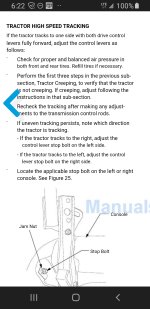

Consult your operators manual. There are neutral and tracking adjustments that need to be made.
