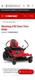

My husband has changed the starter solenoid, air filter, bought a new battery and still won't even turn over. It's a 679cc zero-turn riding mower only a year old. Any advice to find the issue would be most appreciated! Our yard is getting tall...no grass just weeds! Thank you!

Need mower and engine numbers please.
Pictures are helpful too.

You can go to the Troy site and download your manual. Here is a screen grab of fails to start stuff.
