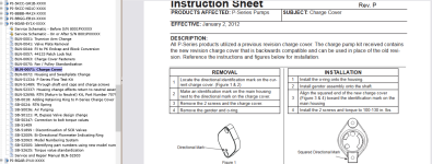

If it is the charge pump cover o-ring which btw is a Dash 144 o-ring it can charged without fully pulling the pump if have good access to it. Just make you mark the cover position as be reversed and change the pump direction. I also recommend changing the pump cover bolts to 12 pt version as the current one are extremely close and extra thin socket maybe needed.

Also need to look at the charge pump cover itself. Is it cast iron or aluminum. If aluminum it will need to be replaced with the cast iron charge pump kit due to the aluminum cover warping which is what causes the leak.
