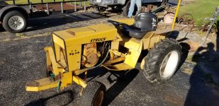

Just finished this last week. Had to clean and Redcoat the tank, replace fuel line, rebuild fuel pump, clean and rebuild carb. It has an OH160 in it

That engine on that Struck Big Job looks like mine. I assume it has the rectangular valve cover with 2 screws holding the breather and valve cover to the head. Where are those drain hole in that breather? I took pictures but I can't figure out how to reduce the size of the pictures to meet the attachment requirements.

The guy already picked up the Struck. I have a OH140 buried somewhere in the barn. If i get some time will aee if i can get a pic of the breather. The kit to rebuild the fuel pump is still available. I just did the one on the struck.

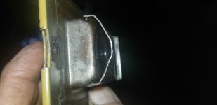

Here is the breather. It is different from the other ones i have seen. This one does not have the drain holes. There is a foam piece in the breather that acts as a precipitator to separate the oil out of the mist and then i assume it runs back into the engine off the sloped piece.
That is what my breather looks like. I blew in on the breather hose and it had some restriction to it. I thought it probably should have had more restriction. I have had the breather mounted with the drain going both ways so I didn't think that would make a difference. It had been on reversed of the original position for several years and never blew oil out.
