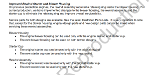

The issue is they are showing the starter for the use after 140601 but nothing for the before numbers. And the new series starte doesn't fit the old series blowing housing. I suspect the only way to get around it would be to order the starter/blower housing kit.

Item number 730D https://www.partstree.com/models/9p...tical-engine/blower-housing-rewind-starter-2/
This may also help understand what is going on. The said in the service bulletin that parts for both are available, but I suspect the previous date code parts have been eliminated in favor of the newer parts.

Goter done......starter 84010941 with flywheel cup 593960 fixed it.
Thanks again to all that pitched in to help,
