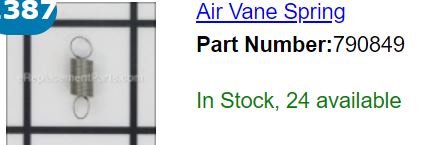

Great response thank you - I guess I am holding the choke OFF to keep it from shutting off. I replaced the air vane spring and that seems tight. But I did not replace the choke return spring ..maybe that is my next thing to try. Thanks again
These air vane chokes are very touchy and the correct spring tension is the key. Spring could have been replaced (incorrectly), or have wrong tension and causing problem.

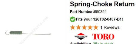

  • / Push mower wont stay running unless I hold air vane open for 45sec
Is there a difference between the
690354 CHOKE RETURN SPRING
699056 GOVERNOR SPRING
I see where the Governor Spring goes but cannot find where Choke Return Spring is installed?
Yes they are different springs. The choke return spring stretches across the top of the carb from the choke shaft to a bracket that is actually part of the carb.

Thanks - see pic. Air vane spring and Governor spring shown. You are saying the Choke Return Spring is underneath the metal plate?
VegetiveSteam
Jun 1, 2022
469
No but I may have to plead ignorant on this one. Yours is different than the ones I've seen. I don't think yours uses a choke return spring. Like you, I don't see where it could go and with what the air vane spring looks to do I don't see the need for a choke return spring. The ones I have seen have the spring and the mounting points for the spring all incorporated as part of the carb itself. Yours is a different set up so I may have to yield to someone more familiar.
