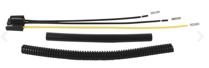

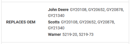

Anyway you need a Aptiv 08911979 connector housing, two Aptiv 12033824 terminals, and a pair of open barrel crimpers. Then while paying attention assemble the new connector assembly by noting which wire is where as this a polarized connector plug.
Or you could get a Stens XMC1001 kit but still a strong pair crimpers, a knife, and a lighter. Hopefully you which end of the knife is the business end.
Prime cadet to be a Space Cadet. I sure hoping you haven't tried gluing your tires and wheels on your automobile yet. How dumb can you get?
Anyway you need a Aptiv 08911979 connector housing, two Aptiv 12033824 terminals, and a pair of open barrel crimpers. Then while attention assemble the new connector assembly by noting which wire is where as this a polarized connector plug.
