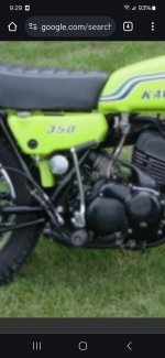

My kawasaki 350 Bighorn didn't have a compression release.
