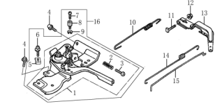

Photo attached

From the picture it appear you are missing both springs if the engine Loncin G210FDS engine.
Item 10 is the main governor spring PN 171600094-0001
Item 14 is the throttle return spring PN 171610002-0001
Now your setup should be more like this as it appears to be a fix speed system. So Item 10 becomes item 3 and Item 14 becomes item 4.
The governor spring is what pulls the throttle vane to wide open and then governor arm 13 push the throttle toward close as the reach the govern speed.
