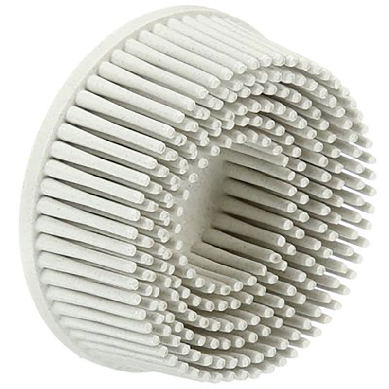

Tip on head gasket replacement. Clean the areas where the gasket goes. And clean it again. You might want to clean this area real good. Get it. Think HOSPITAL clean here.
Stay away from metallic scrapers. Use the below link instead.
Degrease the gasket area with foaming window cleaner and clean paper towels. The paper towel will show you if the surface/s are still dirty. Look at your used paper towels for evidence. Don't use brake cleaner as most lazy people will do. You need the scrubbing action to remove ANY contaminants on the aluminum.
Torque the bolts in 3 stages to factory specs.
Lastly you MUST use some spray tack or the head gasket will fail again over time. Read the directions and shake the crap out of the can.
