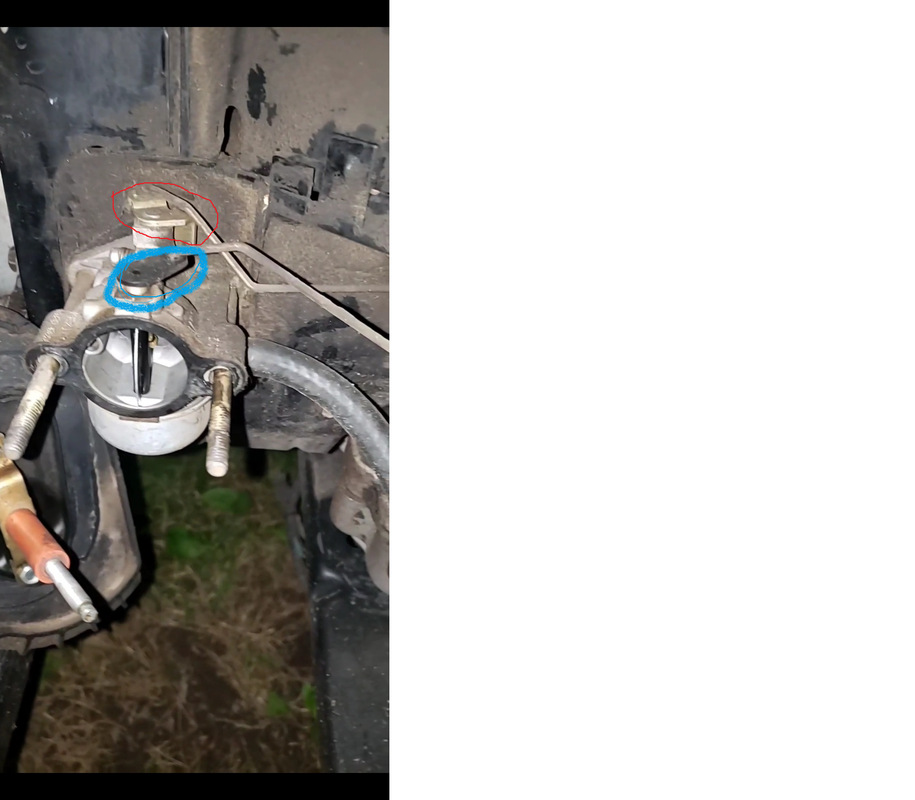

I found the right parts the engine is different. The guy who sold it to me didn't tell me that, found the new carb online if I need. I just hope I can find better videos on adjusting the throttle, the cable is fine but still dies in full throttle as it STILL closes the valves as soon as it hits full throttle. Ugh

Let me back up one step to be sure we're on the same page....
When you put it up to full throttle, which one closes, the one circled in Red or Blue?

If this is a CV15S, I just worked on one. If I could get a wider picture of the carb linkages, might be able to help.
For the two linkages, one will push in at full throttle slash choke setting about an inch roughly, and only that much. That is your choke linkage. Other one should move in concert with the throttle lever. This latter one is your throttle linkage.
Far as the engine losing power at high revs, are the block and cooling fins clean? As in a new engine looking clean? Wondering if this one is overheating. Carb area is pretty filthy. What's under the metal engine cover? Bet the cover has never been off.

Some tractors are set up to choke when the throttle is in full forward position. Once it starts, you must pull the throttle back to the run position.
Could this be part of your issue?

I got a 2004 Ariens Zoom34. I had the deck leveled etc. I was noticing odd level cuts, heard my engine might not be runnin fast enough. Turns out that & uneven tire pressure seems to be the blame. I have a slower time starting it btw also, but I noticed at idle & high idle it is okay (I even popped the air filter plastic off to check throttle movement from inside the carb). It works fine but only at running speed is the throttle actually wide open. When I put it in full throttle, the plate closes back up as the screw pushes & makes contact with the linkages on the carb. Here's a picture with throttle lever in the groove at running speed, again full throttle closes it back up & its bogs down or will die under blade running. Help
It sounds to me like that your throttle needs adjustment. It should be wide open at full throttle. Try pulling back on the throttle until the butterfly is wide open and then see how it runs.

The engine design with auto choke. Also the engine disigned max RPM is 3000 rpm with an idle speed of 1400 rmp. In order to go any higher you need to remove the choke linkage and install a manual choke. In this case you need make up a bracket to hold the choke cable..

Do you have a seperate choke lever or control? If not then pushing the full throttle all the way engages the choke flap for startup. Once running you pull back on the throttle till it runs smooth. That position is full throttle. Take a picture of your throttle and or choke setup on your ariens dash.
They both appear to close. The blue definitely but the red one pushes to the left direction also (if ur looking at the pic)
