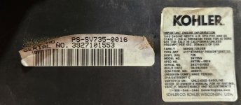

Hello all i have a 26hp kohler engine that i need help finding the starter for. The parts diagrams all list the starter but only give the part number for the non solinoid shift version where thats the one i need.
Craftsman version
Ps-sv735-0016
Craftsman version
Ps-sv735-006
Go back and check your spec number you are missing a digit. And Kohler OEM starters normally have the part number on the starter housing.
Yeah i missed one on the thread post my bad i thought i attached photo tho! Ill hafta fix it in a sec

I got home finnaly and went to take a picture resized due to the file was too big but this is what was installed on the engine
