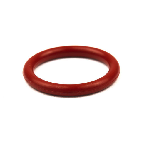

Hi Folks. Looks like I have oil leaking at the bottom end of the dipstick tube. I've wiped it off and will run the mower again to confirm it is the seal. I'm in Sarnia Canada and it looks like a replacement seal (part # 692296) is a whopping $25 which sticks in my craw. Briggs and Stratton sell them for $3.50 but won't ship to Canada. There is an industrial supplier in town and I am tempted to drop by and see what they have in the way of O-rings. I need to ensure that the material will take the high temperature but am not sure what that would be. Also needs to be oil resistant.
Your thoughts would be appreciated.
Sincerely Grouseman

I google part # for OEM part & best price.
HAPPY FATHERS DAY! https://www.partshouse.ca/oemparts/partsearch/briggs_stratton?partsearch=692296
$24 now in Canada to resolve an oil leak with OEM B&S part, drive across the border to B&S parts store or wait 6 months & recheck price which will likely double like gasoline, groceries, & all consumer goods. I fully understand your frustration & have been there many times, try taking measurements of old o ring with caliper & look on Amazon for heat & oil resistant “o” rings your size.

It doesn't get that hot. A harbor freight o ring will work.

I'll bet the existing red one is high temp silicone but still a good idea.

A standard -115 Viton or Silicone O-Ring will work ... you can find these at any industrial supply house or amazon.
My B&S on my 1996 Lawn Boy 10517 was leaking at the same spot.
We have O-Ring stock where I work, so I matched up the original O-Ring to a -115. We have both Viton & Buna-N, but the Viton is higher temp so that is what I used. The Viton we have is 70 Durometer which seems to be a little firmer than the original silicone ... whether a firmer seal is better or worse for the application I don't know. Leak has stopped so that is all that matters to me. It is not too difficult to replace so if I have to change it again sooner than an OEM B&S seal would last, no big deal.

Happy ending. Found some 115 o-rings at a local machine shop. Nice guy gave them to me and I gave him $5 for coffee. Installed red one which I now think may be Viton. Problem solved.
Thanks for the input especially from Doug for the o-ring size and info on Viton.
