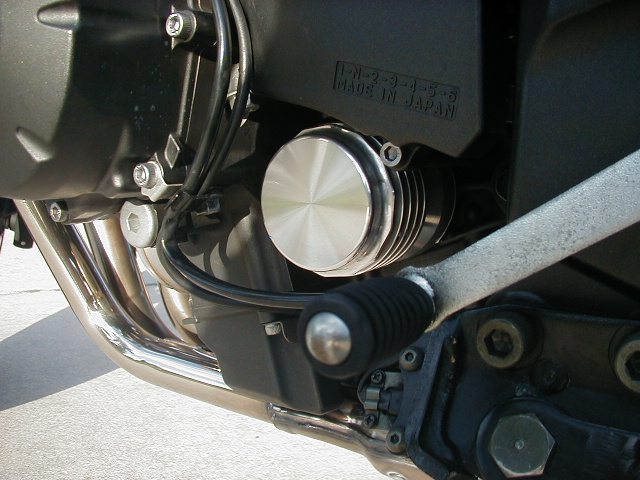

Lastly, to throw one last bone into the mix, this is the oil filter I've run in my the last 10 years or so. Expensive initially but paid for itself already, many times over:
I wouldn't use anything but semi-synthetic oil in the engine (Motul, 10w40), as it'll red line at 14,000 RPM, 95 HP, so IMO, cutting back on the price of oil or filter is NOT an option I'd personally take..
