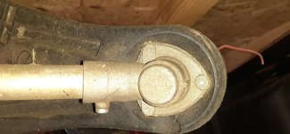

I bought a new Echo String Trimmer (SRM-225) last year and when I went to add some grease I noticed they no longer have the grease bolt/point on the head.
Not sure if this was done so it won't last as long (haha) or if they expect you to take it to a dealer to service. Any thoughts as to why this was done?
I guess it'll have to be disassembled and then manually greased? Thinking about adding a tapped hole making my own grease point while I have it opened.
Just would like some thoughts as maybe there was a reason they did this. Thanks!

Chubby, my SRM225 does have a 10mm hex bolt that acts as a plug to use a rubber-tipped grease gun accessory to lube the gearset. Since you would have to disassemble to drill/tap hole for zerk fitting for yours, I guess you would have to decide what to do. Reason they did this? I would bet it was to save the $1.00 per unit to drill/tap/plug.
